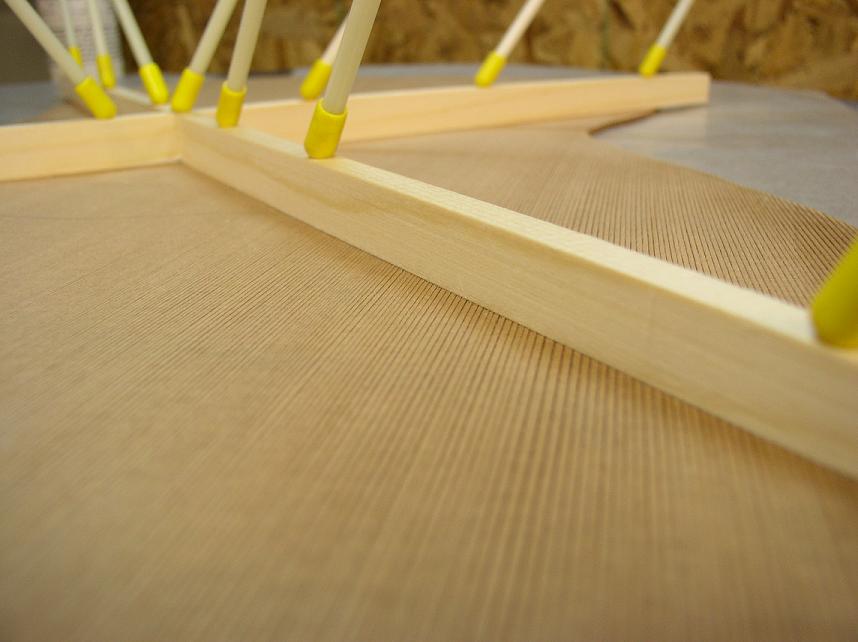

I have really been on the fence about whether or not to buy one of these high priced glue removing tools.
I finally caved and bought one.
This thing simply put, ROCKS!
Here is a close up of a brace to redwood joint.
It makes a nice tight fit between the brace and the plate and does a great job!
I am very picky about the inside of my stuff and I honestly feel this will help me to do a better job.
I would highly recomend this tool to any builder at any level.

WOW, I thought your work was clean before you got this Lance.
You better be careful, you may just turn into Hesh and become an ultra neat freak
Good on ya, early Christmas present

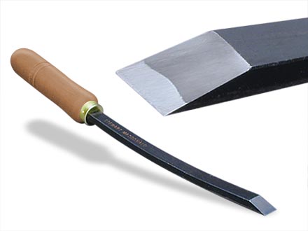

it is a great chisel. I have had one for years and it works great. Recently,
because I'm a tool whore, I got three of these. They work equally as well for
about half the price...
http://www.diefenbacher.com/Special%20Chisels.htm#Curved%20P aring%20
Chisels

Lance don't even try to pass that photo off as real...we know there's no glue under that brace. You just stuck those bars on there to make it look like it.
You are the King of Clean, no doubt.

[QUOTE=John Mayes] it is a great chisel. I have had one for years and it works great. Recently,
Chisels
John, are you referring to the curved chisels only? Thanks.

Okay, now that you've taken the picture dry, let's see it again after you glue it.
You know, kind of a before and after photo comparison!
Merry Christmas a little early. I'm jealous, but happy for ya!

Yeah,I love this tool. Mr. Clean is now going to be Mr.Ultra Clean! That pic does look super clean Lance!     You is amazin'!

[QUOTE=Bill Greene] Lance don't even try to pass that photo off as real...we know there's no glue under that brace. You just stuck those bars on there to make it look like it.
You are the King of Clean, no doubt.[/QUOTE]
I was gonna say the same thing...Come on and squeeze in some glue.

[QUOTE=Bill Greene] [QUOTE=John Mayes] it is a great chisel. I have had
for
aring%20
Chisels
Well I have a full set of the std bench chisels too, but for this discussion,
yes the curved chisels. The 16mm is my favorite.

Stew mac sells a chisels that looks like this but they sell theirs as brace carving chisel. Is this the same thing? If not whats the difference. Just wondering. By the way Lance that is one clean top.

I've tried it. It sorta works. If you don't care about getting it really clean
it works. If you really care about getting all the squeezeout, and it's
residue so that your braces look like they are just laying together....like
lances photo. then that technique does not work. Take a close look
inside a Taylor. They are fine guitas, but not totally pristine...they can't
afford to be making hundreds a day.

Here is my version of that chisel. Bocote handle and A2 steel. If I can't make a decent guitar yet at least I can make the tools!
PostPosted: Sun Dec 16, 2007 6:48 am
Sweet Kevin! How did you make it?

The LMI glue clearing chisel was one of the very few tools that when I started building guitars I purchased correctly.   Most of what I bought in advance of learning to build ended up being either junk or useless for how I build.
This is a great chisel.
Scott I sharpen mine on wet stones, not in a guide, by hand taking care to use my fingers to keep things lined up.  It works fine for me.

Now Lance - just when I thought that I was catching up to you on top cleanness you go and buy one of these.........

I was taught by Sylvan Wells to use them for brace shaving also, especially
taking the ends down to zero. Much more comfortable tool to work with
than a straight chisel.

I may have missed the post, but what make (brand) is the chisel you bought?

PostPosted: Mon Dec 17, 2007 1:11 am
Randy,
Its from LMI
You can find it Here
